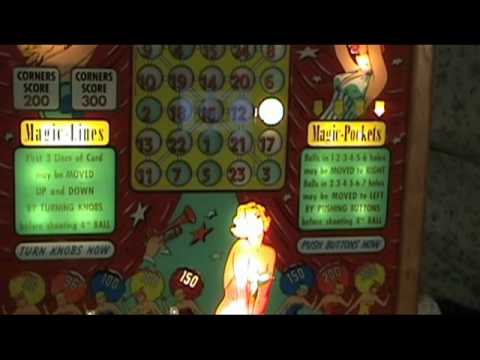

Bingo Play Primer?
By zacaj
6 months ago
Stats
  • 3 posts
  • 3 Pinsiders participating
  • Latest reply 6 months ago by bingopodcast
  • Topic is favorited by 2 Pinsiders
Find
Search this topic for posts matching certain words or written by a specific Pinsider. Or both!
    #1 6 months ago
    I've got a Bally #gayety that I've been fixing up, and as far as I can tell it's working now (though it's hard to tell because of how random they are...), but I've got to admit after playing some games on it I don't get the appeal that much. Are there any good guides or videos out there explaining the intricacies and allure of bingo play? I feel like one of those pinball newcomers who is surprised when they learn there are rules and you can aim.
    #2 6 months ago
    Check out this link of a Bally Gay Time bingo pinball machine which is almost exactly like a Bally Gayety bingo pinball machine.
    Here you will learn a little bit about the operation and features of the game.
    Understanding the Magic Pockets and Moving Lines feature are an important part of the game play on Gayety or Gay Time. The odds payout scoring and Red and Yellow lines, corners when lit, Spot numbers 25 or 10, extra ball all play a part in the game play.
    The most important thing is learning how to maneuver the ball around the playfield to make the correct number to score replays or free plays. This will take some time and is the fun part about the game. Its a real challenge to make numbers for in line wins and takes some practice, but worth the effort.
    Here's a Gayety is action with many features lit including extra balls.
    Bingo are fun and interesting to play once you really put the time into learning how
    to literally play them and understand how all the features work on your game. They require a skilled
    pinball player to move the ball around the maze like playfield lay out to make numbered holes for in line wins or replays.
    Making numbered holes for in line wins is the skilled challenge and what makes them interesting to play and fun when you can beat the game for replays.
    How to play a bingo pinball machine and make numbered holes for in line payouts.
    Well, how can you describe in words how to make a numbered hole on a bingo pinball playfield to connect for "in line" wins especially the "bally hole number"
    which is the number 16. The 16 is one of the harder numbers to make, but there are also many other tough numbers to make like the 4, 15, or 17 to
    name a few which to me are just as hard to make as the 16.
    First of all there is no secret or magic trick to making the numbered holes you need. The best thing any player can do is play a bingo pinball machine
    everyday or as much as you can to give yourself a chance to get a feel for the way the ball rolls around through that "maze like field" of numbered holes
    on a bingo playfield. The foundation of a "stance and style" is important too. I hold the cabinet with my two hands tightly gripping the wood or metal side rails
    starting at the top of the playfield after hooting a ball from the ball shooter lane. Then quickly when needed sliding my hands downwards when the ball moves
    downwards but always keeping my hands even with the ball as it travels downwards. Example: If I am trying to make the number 23 my hands will end up at
    the bottom of the playfield side rails after being on the top and middle of the playfield side rails as the ball travels down. I find that I have more control of the ball when my are hands "horizontally" even with the location of the ball on the playfield making it easier to try to make the ball go where I want it to go. I also have my left thigh wedged under the cabinet in front below the coin door at all times while the ball is in play too. This helps me a great deal for balance and comfort as part of my "stance and style" and shaking when necessary. I always play crouch down some and bent over forward leaning down towards the playfield leaving only 8" from my eyes to the playfield glass, for that feeling of becoming part of the machine and always concentrating very hard with every move the ball makes. You know the old saying practice makes perfect and you will need plenty of time in on a bingo pinball to make some of the numbers on the playfield you need for a in line wins or "hits". A hit is a slang term use by bingo players for collecting wins or replays for in line or numbered lights in a row on a backglass bingo card.
    Being a serious bingo player and gambler on these magnificent games of luck and skill for over 30 years growing up trying to make a living off of them as a kid
    and playing mostly everyday, I am no expert, but the 16 can be made several ways if the playfield is correctly shopped out. Before I explain how to make the
    16 or any other numbered hole, the first tip and the most important tip I can give in playing a bingo pinball, is to only and I mean only shake the machine when you need to move the ball in your favor towards a numbered hole or away from a number hole you do not need. Shaking is the key to learning how to make a numbered hole and becoming a great player. It's like any other game that is new to you. To understand when to shake and when not to shake requires the person to learn this by themselves from getting a feel for playing a bingo on their own daily. The way I play is, I only shake when I need to, carefully watching the ball at all times and always ready to shake in a spit second if needed. When playing a bingo pinball you must be very focused and you need strong concentration while the ball is in the playfield heading for a numbered hole. Sometime you need to make the ball take it's natural path only shaking it away from all numbered holes except the numbers you need to make in order to get a winner. This will come when a new or novice player has dedicated some time each day to play and study the natural path of how the silver ball rolls. Once you have reached a "fair" to "good" level for playing a bingo you are now ready to look for the common rolls for making the 16 or any numbered hole on the playfield.
    Here we go:
    First always shoot the ball on the correct side of the playfield for your needed number in line. The correct side of the playfield will be the side which you have a better chance of making the 16, you do this by following your blockers. "Blockers" are the balls already shot out that are now sitting in a numbered hole on the playfield. By controlling the ball in play and making the ball in play hit another dead ball that is already in a numbered hole you give yourself a better chance to make it to the 16 or any other number you need before dropping in a unwanted numbered hole. Blockers are another important part in making the numbers you need for in line winners. Getting the ball near the numbered 16 hole is the first thing on the list to do. Using your "blockers" and being on the correct side of the playfield will give you a chance at making the 16 or any other numbered hole you may need.
    Lets identify and label the 5 bumper posts that are just above the third row of numbers 14, 15, 16, 17, and 18. We will label the 5 posts from left to right A,B,C,D,E. One of the most common ways the ball goes in the numbered 16 hole is by getting the ball between the B & C post or C & D post. Once the ball is there you can watch it closely and not choose to shake or and take your chances of the ball going into the 16 on it's own or when the ball is there you can shake the ball side to side gently between post B & C or C & D which ever two post you have the ball at and then watching it closely just as the ball is hitting post B or C for the last time is when you stop shaking side to side and try to allow the ball to drop into the 16 hole.
    A lot really depends on if the bingo machine playfield is shopped correctly in the players favor for making the numbered holes you need for winning.
    Having good rubbers on the posts is a must for starters. Most operators would have dead rubbers through out the playfield posts and the tilt set very
    sensitive so the player wouldn't be able to control the ball at all, therefore taking away a players skill for making his numbers needed to win. This
    condition of the playfield could not give the player the best opportunity to make numbers for pay outs which allowed the operators to make a fortune
    in cash from players losing all the time. In home use have new bouncy rubbers and the tilt set in favor of the player.
    I used to put a empty soda can behind the machine in the center top section of the back box (or head) and have a friend or partner I was playing
    with push the machine forward, so I could wedge the soda can in between the wall and the back box (or head).By doing this it would give the machine
    some stiffness and wouldn't allow the tilt bob to move or swing back and forth as much when trying to shake the machine to make a number therefore giving back some advantage to the player for winning. This helped me a great deal, but some bingo players hated my can trick invention and would pull the machine backwards towards them allowing the soda can to drop down to the floor. I new this because I would find the soda can on the floor under the machine and have seen them do it after I got off the machine. If I wanted to play again, I would have to set back up the soda can which always wasn't easy to do with the owner of the of the place watching you most of the time. There are other things players used to do to rig the games in their favor but operators and store
    owners didn't like it, but it was always all right for the vendor or operators to rig the machines against the players.
    What great times I had hanging around bingo pinball machines. It was the main attraction in my life for a long period. I have met all walks of
    life that shared the same interest in these very addictive pinball machines because of the chance of winning cold cash at that very instance. That was
    the real draw to these fantastic games when they were on route back in the day. Being a poor boy growing up on the streets of Newark, NJ and never having any spare money, knowing I had a chance to turn 2 dollars into 20 dollars or more was a big deal.
    The most I ever one on a bingo machine happened twice in a short period of time when I was 29 years old in the late 1970's after playing bingo's for at least 15 years. It was playing on a bingo called Dixieland and just cracked open a fresh 10.00 roll of quarters. I needed the number 21 for 5 in a line on the sixth card, plus I had the magic number and the sixth card was paying a double double feature that was lit. After making the 21 "like the ball had eyes" I then had the nerve to double down the double or nothing feature that comes up at the end of the game making my 1200 wins turn into 2400. That’s right, the total pay out was 2400 replays at 25 cents a replay which equal a cash out payment of 600.00 not bad for putting in the maximum coin limit of 11 quarters. Remember I did this twice in a 6 month period. I didn't cash in right away because I felt I was going to get another giant hit again but didn't and played the re! ! plays down to a even 2000 replays cashed in. This Dixieland was a brand new one at the time and wasn't on location that long, so it had good rubbers on it and played to a bingo players advantage. The store owner I new from being a constant player at his location so he paid me what he could and told me to come back tomorrow for the rest of the money. He was in a state of shock when he heard the sound of 2400 replays being racked up on the replay meter. There was one catch the next day when he paid me in full. He said that I was not allowed to play there for a while that I was barred from the premises. He did let me back in the store and play again after about two weeks or so, but the game had been rig by the operator with dead rubber rings and the tilt very sensitive. So I played a few games and left that place. There were plenty of other locations through out the city to play, so off I went.
    All my bingo's in my collection have Wico 5/16" super high bounce rubber rings making my games play like a dream. These Wico or any good brand
    rubber rings allows a player to make most numbered hole without using much shaking at all because the ball just is very alive from good bouncing
    action, which none of the operators had when bingos were out on routes. Having the playfield level, waxed and a great set of rubbers rings, plus lively playfield
    springs make a huge difference in play when trying to make numbers for hits on a bingo pinball machine. Making the 16 or any numbered holes takes
    some practice, but with the bingo correctly cleaned, waxed, new rubber rings you'll increase your chances of winning, which makes it more fun and less skill.
    Well for me the thrill of playing the bingo's will never be what it was 40 years ago, but having them down in my gameroom brings me
    comfort, joy and memories that stay burning bright in my mind and I still love to play the Bingo games even today.
    #3 6 months ago
    At its core, on a bingo, you are trying to get three, four or five numbers lit in a row. Your odds are displayed at the bottom of the glass - smallest number being 3 in a row, middle 4 and largest 5.
    A bingo has multiple phases of play. The random nature is not from the gameplay (shooting the balls and targeting/landing in a hole) but from the betting phase.
    Phase 1: Coining/betting. At this phase, you are putting in nickels to try to increase your odds for winning. On Gayety, your first nickel will reset the machine and give you default (lowest) odds. Your second nickel gives you a guaranteed advance in the odds. Any nickel play on Gayety -can- also award a feature. Nickels inserted above the second odds give a -chance- at earning an increase in odds.
    The randomization happens through mechanical coordination of multiple units within the game. The primary award unit is the Spotting disc. It is attached to a series of mixers will will allow/disallow award of feature or odds jump. If it makes it through that, it also has to make it through the reflex unit, which is the auto-portioning unit of the game. If you win a lot of replays, it will take a slightly larger number of nickels to guarantee award of any given feature or odds jump. The reflex is a very powerful invisible force in the bingos.
    Phase 2: You're coined up and ready to play. Shoot your first ball, and aim for the number with the most connections in the center of the card. By default on Gayety, this is #16. If you have the Magic Lines qualified, you can turn the third knob to change that center number to 14, or, more importantly 1!
    Continue play, aiming, nudging, pulling, pushing the game until:
    Phase 3: Decision phase. Let's say you also have the Pockets qualified. Before shooting your fourth ball, you have a ball in #7. You also have 12 and 25. You can move #7 into #1 physically and put together a win for three in a row. This is also the last time you are able to reposition the Lines, so pick the best number for column 2 to shoot for to get four in a row.
    Continue play until:
    Phase 4: Endgame. Let's say you have a winner, but it was a paltry three in a row. You have the decision to continue your game at this point by playing for a random chance at extra balls (up to three). Based on the mechanical portioning noted above, you can get an instant or slow award of 1st/2nd/3rd EBs.
    In total, you have the possibility of 8 chances to get 5 in a row. Pretty good if you can make your numbers.
    A big part of playing is knowing the different number combinations on the bingo card. How can you move the numbers around to make the winners? Is it possible? Should you throw good money after bad and try for extra balls? How confident are you that you can make that #4?
    The other big part of playing is knowing how to influence the ball. Try different play styles until you find one that works for you. I like to play with a "modified Vic Camp" style. Playing very actively, moving my hands down the siderails as the ball travels. This gives me good ability to apply my nudge/push/pull in exactly the spot I want. I also have incorporated some of my nudging from the lockbar, after seeing several successful Baltimore-style players (like @okorange). I am still practicing this art, but the basic concept is to very quickly push the lockbar forward and pull it back, essentially sliding the playfield.
    One more big part of playing: knowing how the ball will bounce, and how to quickly get the ball to a number hole you need or bring it back home to the ball return to replay. Hitting the post above #2, and being able to bounce it over to #12 is very important. Practice, practice, practice.
    I find the skill required to do all this without tilting very challenging to learn. I am still learning and I play a LOT. Not as much as I could, but I love these games. Each one has its own unique set of challenges. They are impossibly deep once you start diving into the games, and they are truly different from ball-to-ball, game-to-game.
    The key to understanding bingos is that you can make the challenge as deep as you choose. You can completely ignore the "Magic" features and play straight bingo. Each of the features is a player advantage, though.
    Always happy to answer questions. I've done dozens of interviews with much better players than myself, including Vic above.
    $ 79.99
    $ 69.99
    From: $ 5,699.00
    Pinball Machine
    Music City Pinball
    $ 9.99
    $ 9.99
    $ 18.99
    $ 36.00
    MONSTERFISH MODS
    From: $ 21.95
    Apparel - Unisex
    Pinball Wheezer
    $ 42.00
    The MOD Couple
    From: $ 49.99
    Medisinyl Mods
    $ 7,999.00
    Pinball Machine
    Little Shop Of Games
    $ 10.50
    Playfield - Decals
    The MOD Couple
    $ 69.99
    € 27.00
    YOYOKOPTER MODS
    $ 69.95
    Hookedonpinball.com
    $ 22.00
    ModFather Pinball Mods
    From: $ 15.00
    ModFather Pinball Mods
    $ 9.99
    $ 9.99
    $ 109.00
    Cabinet Parts
    Tilted Pinball
    $ 26.50
    £ 32.00
    $ 7.00
    Various Other Swag
    Project Pinball Charity
    From: $ 9.99
    Note: This is an old thread. The last post was made to it 198 days ago. Resurrecting old threads is not necessarily a bad thing, if you think the topic is still relevant and/or your post is beneficial to it (e.g. following up on something). In other cases, it might be better to create a new topic.
    Wanna join the discussion? Sign up for a Pinside account, or log in if you already have an account.
    Hey there! Got a moment?
    Great to see you're enjoying Pinside! Did you know Pinside is able to run thanks to donations from our visitors? Please donate to Pinside, support the site and get anext to your username to show for it! Donate to Pinside
