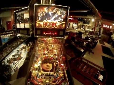

Stern warranty and tech support
Started 2 years ago by Av8 in forum TechTech: Generic.
Forum » Tech » Tech: Generic » Topic
Stern warranty and tech support
  • Started 2 years ago by Av8
  • 23 Pinsiders participating in this thread.
  • Latest reply from Hwawonyu
Tilts/ ignores / abuse
Sharing and favs
Topic poll
  • poll:
    good : (28 votes)
    68 %
    fair : (7 votes)
    17 %
    bad : (6 votes)
    15 %
  • Games linked to topic
    Help us build a pinball game knowledge base by linking topics to the games discussed in them!
      2 years, 1 month ago
      how long is the warranty on a nib pin? how would you rate their tech support?
      2 years, 1 month ago
      Not sure about Stern because I have not received a NIB from them. I heard JJP is going to be three years.
      2 years, 1 month ago
      My buddy just got a routed Family Guy from a distributor. He emailed Stern tech support and Pat helped him with no issues. Solved the problem first try too. I'd say that is awesome service...
      2 years, 1 month ago
      tomdotcom said:
      My buddy just got a routed Family Guy from a distributor. He emailed Stern tech support and Pat helped him with no issues. Solved the problem first try too. I'd say that is awesome service...
      A lot of pinheads have said that of Pat.
      2 years, 1 month ago
      I can't find info on parts warranty on there webpage.
      2 years, 1 month ago
      Check you Manual.. Its in there. Or contact your distributor.
      dung
      Pinball addict
      1,382,100 2
      2 years, 1 month ago
      I have heard of people calling about DE games. I believe they have had the same guy running tech support through all three companies.
      2 years, 1 month ago
      1-800-kickers for stern/sega/de if i do believe so myself?
      2 years, 1 month ago
      absocountry2 said:
      Not sure about Stern because I have not received a NIB from them. I heard JJP is going to be three years.
      Umm Sorry wrong.. I heard this and had to go look this up my self cause thats INSANE to be able to cover it that long.
      From JJP Website
      OUR WARRANTY
      Q- What is your Warranty and what does it cover?
      A- Our Factory Warranty is One Year on the main game board, Commercial 26" LCD Monitor and certain game parts which will be specified. We promise a No-Haggle support system which is Distributor friendly.
      2 years, 1 month ago
      Ballsofsteel said:
      1-800-kickers for stern/sega/de if i do believe so myself?
      1-800-Kickers helped me on JP.. I had No Upper p/f GI's .. My Pin Tech was in the hospital @ the Tyme, anyway they Guided me thru Several Test's .. Final Result ( I had a Bad Bridge Rectifier )
      Awesome service w/ that 800 #
      Also , CoinTaker told me if I Ever have a prob- w/ my NIB AC/DC Prem- ( After I get it that is )
      I should Go thru him !! ( He Will be my Customer Service ) So I Can't Vote just Yet...
      2 years, 1 month ago
      You are getting a NIB AC/DC?
      2 years, 1 month ago
      Always had excellent support when calling Stern. Very helpful. Very quick.
      2 years, 1 month ago
      brz said:
      You are getting a NIB AC/DC?
      Ohh Yea,,, Premium !! I already paid 1/2 of the cost as a deposit.. Look's Like I'll be Play-n 1 in Texas B-4 I get mine tho.. Hmmm!! Could be a Good tyme to Judge it and see if it's Worth 6K.
      Anyone Ever Put a Deposit down on a NIB ,, then played 1 before Yr's was purchased & Ship'd , and didn't like it and Asked for Yr deposit back ? Seem's Fair to me if you Did !!
      2 years, 1 month ago
      I have purchased many nib, and had excellent support
      2 years, 1 month ago
      i called about a de game about a year ago and they helped me out. i dont remember who i talked to but they were great.
      2 years, 1 month ago
      I never new you could call about DE. I have ACDC Pro coming. I would expect a year warranty but still no real answer. Who has a NIB TF that can look in manual or tell how long the warranty is?
      Thanks in advance.
      @BR - Premuim pics looks sick. I will probably buy it later. Just cant wait. Pro rocks too.
      The NEW videos Im seeing today, (with experienced players!) shows a great game with FAST challenging game play and FLOOOOOW!! Lots of it. Back handed ramp shots. Plus those TNT targets will slap you in the face and make you want more.
      2 years, 1 month ago
      Re TF pro......from the manual:
      Printed circuit boards psb's: 2 months
      Dot matrix display pcb: 9 months
      Warranty periods are effective from the initial date of shipment from seller to its authorized distributors.
      Wow...thought it was a year.
      Have over 600 plays and nothing has gone wrong....flippers are as strong as day 1, canyon fires as fast as first play...only one bulb burned out.
      2 years, 1 month ago
      Have had a couple calls to Stern, they have always been very helpful.
      2 years, 1 month ago
      Hummm, I had Stern cover Boards for a Year no problem in the past 12 Months. We cover our sales for 30 days Bumper to Bumper and 1 year on Circuit Boards.
      2 years, 1 month ago
      tomdotcom said:
      Pat helped him
      Yes, Patrick Powers and Chas in Tech Support are the front line for Stern. Gary probably has no idea just how valuable they are! I have dealt with Pat on many occasions and he is just superb to work with. To me, Stern has terrible public relations, and Pat IS their only public relations! I hope he is appreciated by G.S. One of the few good images I have of Stern is Pat!!!
      2 years, 1 month ago
      The only time I had to call Stern was for Pintucky's LOTR. Pat was great to work with. Luckily I haven't had any problems with my two Sterns.
      2 years, 1 month ago
      The very few times I have had to call Stern support (when I was an uber newbie) they were very helpful and responsive...I was pleasantly surprised.
      2 years, 1 month ago
      I haven't had to use my NIB Stern warranty as of yet, nor contact their tech support. Knock on wood...
      2 years, 1 month ago
      Newer Sterns seems to just work. Rarely do i see a worn out plafield either.
      My Pro shipped today.
      StevenP
      Pinball master
      3,329,000 4
      2 years, 1 month ago
      Stern/Sega has always had very good tech support. Although when my NIB LOTR LE flipper transistors fried (at 2 and 7 months or so), I didn't bother with tech support and just replaced the transistors myself. Saved a lot of time and hassle. But when the gold lockdown and siderails tarnished within a month (my hands were clean!), they sent new replacements.
      2 years, 1 month ago
      StevenP said:
      But when the gold lockdown and siderails tarnished within a month (my hands were clean!), they sent new replacements.
      StevenP, just curious--did they ask you to return the tarnished components?
      3 months, 3 weeks ago
      I was wondering about the Stern warranty and found this thread. Does anybody know if the below is still their printed warranty? They do not put it on their site that I could find. I have heard of people getting help outside of the info below, so I think they go above and beyond what they print - big props there.
      Vyzer2 said:
      Re TF pro......from the manual:
      Printed circuit boards psb's: 2 months
      Dot matrix display pcb: 9 months
      Warranty periods are effective from the initial date of shipment from seller to its authorized distributors.
      I was wrong on the JJP warranty period. I stand corrected. I wish I would have went back to this thread at the time. I have always looked up to gexchange, but I am disappointed that as a distributor you took the time to look up the JJP info but did not post the actual Stern warranty. Is that only info after a purchase? I am considering a machine and it is something that I consider when doing research.
      Gexchange said:
      Umm Sorry wrong.. I heard this and had to go look this up my self cause thats INSANE to be able to cover it that long.
      From JJP Website
      OUR WARRANTY
      Q- What is your Warranty and what does it cover?
      A- Our Factory Warranty is One Year on the main game board, Commercial 26" LCD Monitor and certain game parts which will be specified. We promise a No-Haggle support system which is Distributor friendly.
      3 months, 3 weeks ago
      Stern covered a DMD with a horizontal line on it 15 months after shipping date and I wasn't even the original owner. Had to go through original distributor, but they covered it. I've used them for other issues and they are always helpful and responsive.
      3 months, 3 weeks ago
      Both JJP and Stern have been amazing in my experience.
      I've never heard "Sorry, that's beyond warranty" or similar "Get lost" type comments.
      3 months, 3 weeks ago
      absocountry2 said:
      I was wrong on the JJP warranty period. I stand corrected. I wish I would have went back to this thread at the time. I have always looked up to gexchange, but I am disappointed that as a distributor you took the time to look up the JJP info but did not post the actual Stern warranty.
      He was checking on that 3 year statement specifically.
      The safe answer is this. Both companies have written policies to protect themselves. Letter of the law. Both do a great job of taking care of their customers and product way above and beyond whats printed. Spirit of the law, or more importantly gaining customer support.
      If they feel abused they can fall back on policy but its clear for the most part that both want to win customer support and loyalty.
      Bottom line is neither has shown warranty issues are worth stressing over in the purchase process.
    Wanna join the discussion? Sign up for a Pinside account, or sign in if you already have one.
    © 2001-2014 Pinside.com All rights reserved. Jump to topRSS feedsHelpContactCookiesDesigned by Keeple
