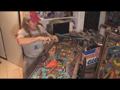

How the heck do I remove this?
Started 11 months ago by Spraynard in forum Technical help.
Forum » Technical help » Topic
How the heck do I remove this?
  • Started 11 months ago by Spraynard
  • Latest reply from ChrisHibler
  • 210 karma points were scored in this topic
    11 months ago | # !! © |
    I'm trying to install a cliffy protector on my BSD rat hole, but I've hit a wall. The posts that flank the hole, which also will hold the cliffy, seem to be impossible to remove! Under the playfield there is a nut, which I removed. The playfield side of the post is totally round, nothing to grab on to. It seems to be threaded through the playfield, and very tightly so. I've tried squeezing it with a wrench and turning, but progress is extremely slow, plus I'm just thrashing the post (rubber goes over it, so I don't really care about that). Is there some trick for removing these that I don't know about? Here's a picture... http://i.imgur.com/MiJcb.jpg
    11 months ago | # !! © |
    Easy, this type is pressed in. Lightly tap it out from the bottom with a hammer. Have your hand on the playfield side to catch it.
    11 months ago | # !! © |
    You need the wrench called "Vice-Grip".
    Lock it down vertically. Gently spin while pulling. Don't pull too hard or you will rip out a big chunk of top wood when reach the end.
    Once the threads get to the wood, it will start coming out easily as it turns.
    11 months ago | # !! © |
    If you are going to use a hammer, make sure you leave the nut spun down to the end of the threads. Otherwise the hammer can mess the threads up.
    11 months ago | # !! © |
    I never had a problem damaging the threads, but I guess it could happen. Anyway the nut on the end will keep it from flying into the cabinet if you miss the catch. Win/win.
    11 months ago | # !! © |
    SealClubber said:
    I never had a problem damaging the threads, but I guess it could happen. Anyway the nut on the end will keep it from flying into the cabinet if you miss the catch. Win/win.
    A Mechanic would have a brass hammer or a brass punch to dislodge bolts from the threaded side.
    Mere mortals back the nut out to the ends of the threads, LOL.
    11 months ago | # !! © |
    vid1900 said:
    SealClubber said:I never had a problem damaging the threads, but I guess it could happen. Anyway the nut on the end will keep it from flying into the cabinet if you miss the catch. Win/win.
    A Mechanic would have a brass hammer or a brass punch to dislodge bolts from the threaded side.
    Mere mortals back the nut out to the ends of the threads, LOL.
    Silly Mortals
    11 months ago | # !! © |
    Lol, I just love fixing things with hammers. Don't know why. Whacka Whacka Whacka!
    11 months ago | # !! © |
    Although I must also admit I love fixing things with a hammer, if it's threaded there are a couple of choices. Wrap the post with electrician's tape, at lest three layers thick and then use vice grips or channel locks. You may have to replace the electrical tape once or twice as it gets torn up.
    Sears sells a product called Robo Grips which, at least used to, include plastic sleeves you could place over the teeth to prevent marring.
    11 months ago | # !! © |
    Video instruction for a patented hole guard:
    11 months ago | # !! © |
    Hammers ? Take your cordless drill and chuck the post into the drill chuck and simply spin out .. Looks like you need to take off the wire form first .
    Jim
    11 months ago | # !! © |
    I've always done the hammer method myself.
    11 months ago | # !! © |
    Hammer method worked a charm. I don't know why I thought they were threaded through the pf. Better safe then sorry.
    11 months ago | # !! © |
    McCune said:
    Hammers ? Take your cordless drill and chuck the post into the drill chuck and simply spin out .. Looks like you need to take off the wire form first .
    Jim
    Ditto. Works perfectly. No damage.
    Chris Hibler - CARGPB #31
    http://www.Team-EM.com
    http://webpages.charter.net/chibler/Pinball.htm
    http://www.PinWiki.com - The new place for pinball repair info
