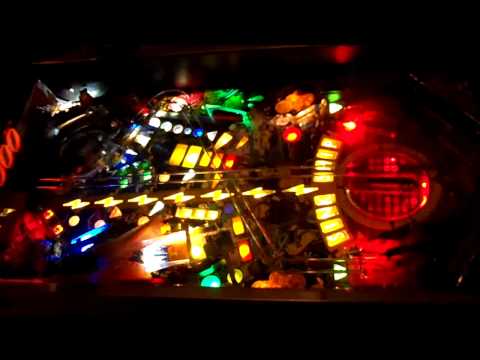

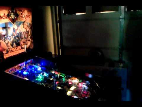

Problem with Black Rose
Started 1 year ago by kalarakis in forum Technical help.
Forum » Technical help » Topic
Problem with Black Rose
  • Started 1 year ago by kalarakis
  • Latest reply from BLACK_ROSE
  • 105 karma points were scored in this topic
Tags
    I have a problem and I do not know from where it produced
    when I play after 2 or 3 minutes it show on the screen
    Locker Doubled
    3 way shot combo
    100.000
    and it stack flippers bumper all work but on screen show this message
    *** I think that is something to do with the door but I do not know where to llok for
    any suggestion
    Kalarakis
    Post edited by robin : Changed topic title to be more descriptive
    It would seem that you have been awarded 100K points for a triple combo shot and that one of those shots in the combo lights the second lock. Is that correct? Maybe you are actually earning the points and the lock.
    Are the three messages displayed at once or is this a sequence of two messages or three individual messages?
    What do you mean when you say that "it stack flippers?"
    Had to lOOK and make Sure you Didn't have a Problem with me.. LOL,, B_R .
    BLACK_ROSE said:
    Had to lOOK and make Sure you Didn't have a Problem with me.. LOL,, B_R .
    Gotta admit, that was my first thought too! But then I thought, how could anyone have a problem with our own expert in diplomacy?
    BLACK_ROSE said:
    Had to lOOK and make Sure you Didn't have a Problem with me.. LOL,, B_R .
    I have a problem with you.... You live too far away from me to buy your pins! Right now i'd have my dream lineup if it weren't for the shipping!
    davewth said:
    I have a problem with you.... You live too far away from me to buy your pins! Right now i'd have my dream lineup if it weren't for the shipping!
    I second that. He should set up a delivery route and see the out-west side of the USA>
    Out-West said:
    davewth said:I have a problem with you.... You live too far away from me to buy your pins! Right now i'd have my dream lineup if it weren't for the shipping!
    I second that. He should set up a delivery route and see the out-west side of the USA>
    Ship-n is No problem,, but it Does make the Pin Cost more !! Sorry Guy's .
    heres me vid's of BR ..
